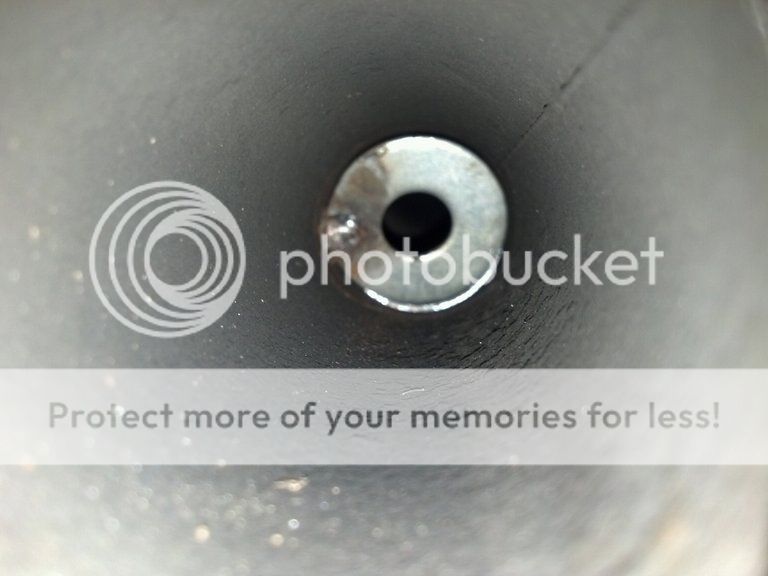

Originally Posted by Kitulu View Post
Pics up!
I did the same thing before stage 3 rejetting/slow jet upgrades; didn't do much to the sound but noticed just a tad more torque. It's here in My Road to Road thread. The welded washer method works much more efficiently though, and depending on the OD of the washer you can tune your exhaust a bit more effectively. I've since removed them.

Originally Posted by razor78016 View Post
Installed the straight pipes, now waiting for my carbs to get back from the tech.
I really like the washer idea because I'd assume it quiets the pipes down a bit, but how on earth did you get those inside the pipe?

This is what the lollipop baffles look like. Mine are installed between the header pipe and straight pipe. I just cut two small slits with my cut-off wheel and slid the baffle in, then welded the slits closed.
Note: I do not own rights to that image, just posting it as demo*
