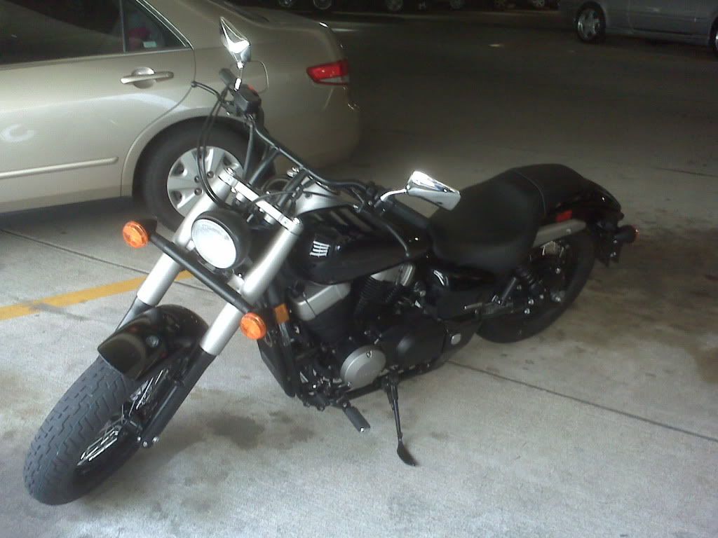

I wanted to add something to this...
I have always been a motorhead and i always believed in running 93 octane in all my "performance" vehicles just because i figured it was the best. In some of my fuel injected mustangs i noticed some slight pinging under WOT with 87/89 in the Houston heat, so i have been trained to always run 93 in all performance cars.
Well, i purchased my 2010 Shadow Phantom a few weeks ago and had the same mentality. I used 93 octane in it since day 1 and drove about 700 miles with only using 93. I was noticing some vibrations over 60mph that concerned me because it was bad enough to make my side mirrors useless. I spoke with a friend who worked at a local motorcycle shop and he told me to run some 87 through it and see if that helped. Well, sure enough about 10 miles after i switched to 87 octane my Phantom is idleing smoother and running better all around at any speed. On the freeway at 70mph the vibration is gone and my mirrors are now working as intended.
Anyway, just wanted to add my .02 because this made a huge difference in the performance of my bike.
-Premium
2010 Shadow Phantom
