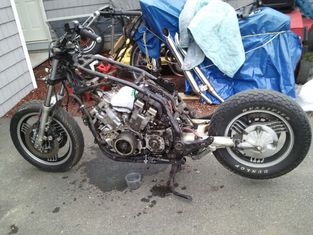

Lastly, and the worst part of all of this, I could have diagnosed the last problem with this bike prior to reassembly if the parts were here on time, long before riding weather hit. I took my bike out last night, rebuilt calipers in place, and found that there is a transmission issue that is not letting me shift into 4th gear.
I have read in the yamaha forums that there is a known issue with a washer on 2nd gear, but I am able to shift from neutral, to first, then up to 2nd and 3rd, but not out of 3rd. I have tried double clutching, revving the throttle, shifting at higher (and lower) rpms, and nothing. It is as if 4th gear is not there. I am baffled and hoping that it is a linkeage adjustment but I fear its something internal that will require a total teardown of the engine.

If the shifting problem is on the Yamaha Venture in your signature then it may be a really easy fix. My old man had the same issue with his when he bought it. There is a pin that isn't held in place very well and pops out. Let me know if it is the venture, and I'll ask him the details.
If I remember correct he just pulled the clutch cover, found the pin, and put it back in.

Thanks for the heads-up Buicknick... you are 100% right. Thats pin is exactly what it was. I found a local guy who did the repair for me back in the spring. Parts and labor was $100, so it was well worth it to me to have him fix it for me!
The venture is crazy fast and a really fun ride. It is side-lined again, though. 44,000 miles ( I put over 4000 miles on it in 30 days) and the mechanical seal on the water pump failed (it was making a whiney noise) and the one-way clutch on the starter also failed. I have to pull some parts for the starter cluch off my donor bike and drop it at the repair shop. Hopefully I get everything done before winter hits, that is the bike I want for my first ride in the spring.

Very cool. I finally stripped the motor out of my parts bike this past weekend. I am bringing it when I finish this post to the shop to have my guy start pulling the one-way clutch for the starter out of it. I lost my skylark too. Woman ran a stop sign doing around 70... ripped the front end right off the car... the hood was bent up over the roof of the car. A truly sad day, I was just coming home from having a quote done to do a custom paint job. Saved me another 1800 bucks at the time.
I have given up on my 4 wheel projects for now. I have my venture which is project enough. Once I got all the plastics off the parts bike, what was underneath actually screamed bobber. The venture looks really cool naked... I actually think I have a pic of mine stripped. Tons of possibilities, if I ever decided to go that way. The rake and the dramatic bars on it (without the plastics) gives it a real mean look... and without the plastic... the engine looks HUGE.
