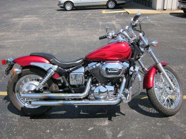

After 7 years of marriage finally talked my wife into not being extremely upset if I bought a bike. So I grabbed a 03 Honda Shadow Spirit 750 w/ 4400 miles. Got a good deal because it didn't run. Guy swore it was the carbs. (interesting thing is he said he paid someone $300 to clean the carbs and install battery and some extra chrome on the bike 4 months ago. Then he just let it sit and now it won't start. So after reading this forum and calling everyone I knew who had a bike I:
Drained the tank and carbs - checked for rust with mirror.
filled with new gas and seafoam.
tryed to start for a second and then just turned over.
Next I charged the battery and pulled the carbs and cleaned them just like I read to do. Both pilot jets were clogged and one of the main were clogged. One carb was much worse then the other one. It had a really sticky float valve that I got moving smoothly.
Then I replaced the plugs, air filter, and a gas line because I tore a hole in it while I was taking it off.
Now the bike starts up with the choke on but if I move the choke at all it will die. I can give it gas but it back fires and trys to die as well.
I read on here that it could be a leak around the carbs so I sprayed for carb cleaner(not sure what I was looking for) on the boots and didn't notice anything going on.
So first question is. What next?
Second question is. The bike has a vance and hines exhaust on it. (installed when the bike was first purchased and they rejetted it at that time. If I need to replace the jets... which is what I am guessing will be the next thing for me to do. What size do I need to get? I am sure there is some information somewhere on this. If you could point me to it that would be great.
Thanks for any help. I am really excited I got a bike but now I am starting to regret the bike I bought. I am taking a motorcycle training course next weekend and would love to have this bike going so I could start driving it before the weather turns bad.

Whether or not you need to rejet at this point depends on what jets it has now and how it runs. While you are in the process of cleaning, and adjusting the carbs, make NOTE of the jet sizes and whether or not the needle is OEM or Dynojet. Do not decide on rejetting till you get the bike running. FWI, based on the burnt exhaust you either gave aleak at the mufflers or are jetted lean. This would lead me to believe the jets are now OEM. Set the pilots 1 to 1 1/2 turn out from the setting ing your manual, as a starting point. Have the battery load tested, just to verify. Fully recharge the battery and keep it on a trickle till you get the bike running.
tryed to start for a second and then just turned over. What was voltage? was fuel pump pumping? Are the Run/Stop and starter switches cleaned? This sounds like either weak electrical or lack of fuel.
Then I replaced the plugs, air filter, and a gas line because I tore a hole in it while I was taking it off. If carbs had been previously rebuilt. I'm thinking there is rust/dirt somewhere in the fuel supply/storage system, lines, pump, filter
Now the bike starts up with the choke on but if I move the choke at all it will die. I can give it gas but it back fires and trys to die as well. This is normalish, if the motor is not warm. Or carbs are not gettung fuel. Floats are a Biatch, getting them adjusted correctly can be dificult and they like to jam and get hung up during installation. Sometime the fix for your issue is to pull the carbs, and reinstall, the jarring will knock the float valve into, out of place
I read on here that it could be a leak around the carbs so I sprayed for carb cleaner(not sure what I was looking for) on the boots and didn't notice anything going on. If you have a leak the idle will change. Have to have it running for this test.
So first question is. What next? Test ignition
Second question is. The bike has a vance and hines exhaust on it. (installed when the bike was first purchased and they rejetted it at that time. If I need to replace the jets... which is what I am guessing will be the next thing for me to do. What size do I need to get? I am sure there is some information somewhere on this. If you could point me to it that would be great. You do the exhaust or the PO????
