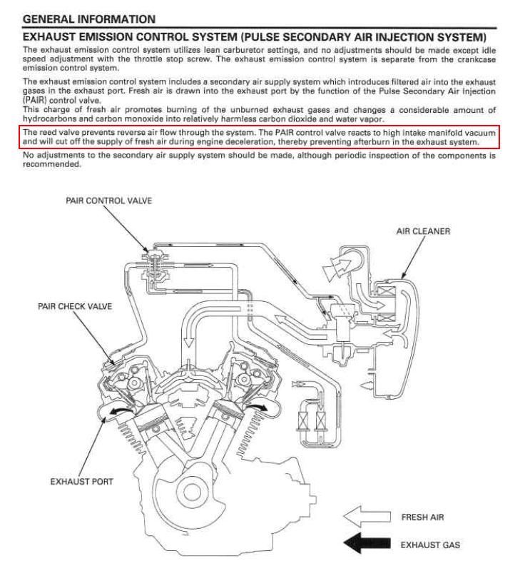

Here's a snapshot from a 2005 Aero 750 shop manual about the system.
Red area explains how it prevents popping on deceleration, but I've noticed a little bit of popping with the throttle
in the "just off idle" position while decelerating sometimes, only briefly.
2008 Aero 750
