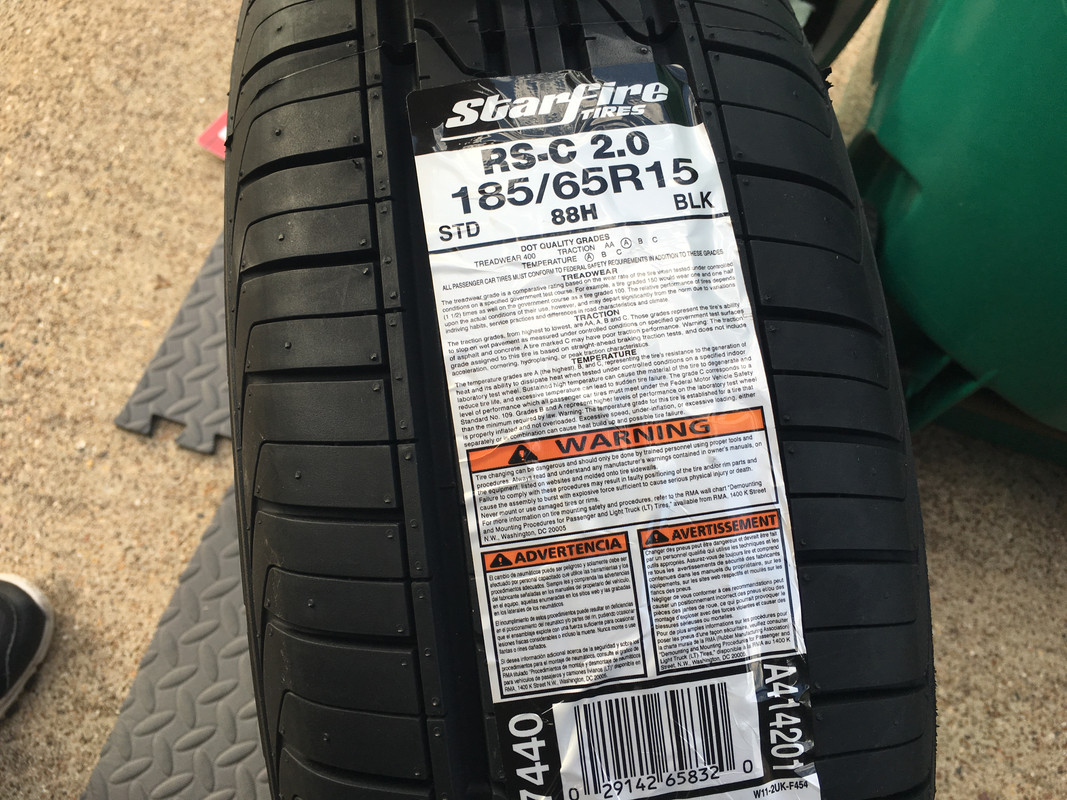

https://s19.postimg.cc/5j5pcjso3/2018-03-02_16.25.48.jpg
Tire is a 185/65/15 StarFire RS-C 2.0 (StarFire is a Cooper tire subsidiary)

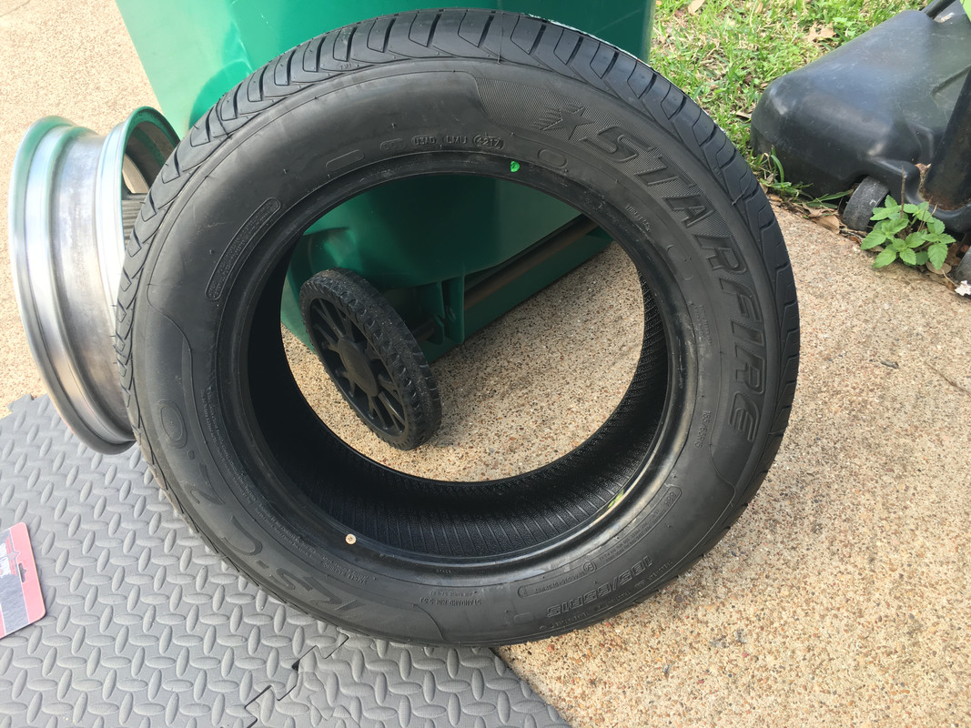

https://s19.postimg.cc/f3pbzfaab/2018-03-02_16.26.05.jpg
Tire is about 1" shorter and 1/2" wider than stock 170/80/15.
Should get me a little more acceleration on the bottom end, and not worried about top end since I don't even get into 4th gear (my top gear) till 65 mph.

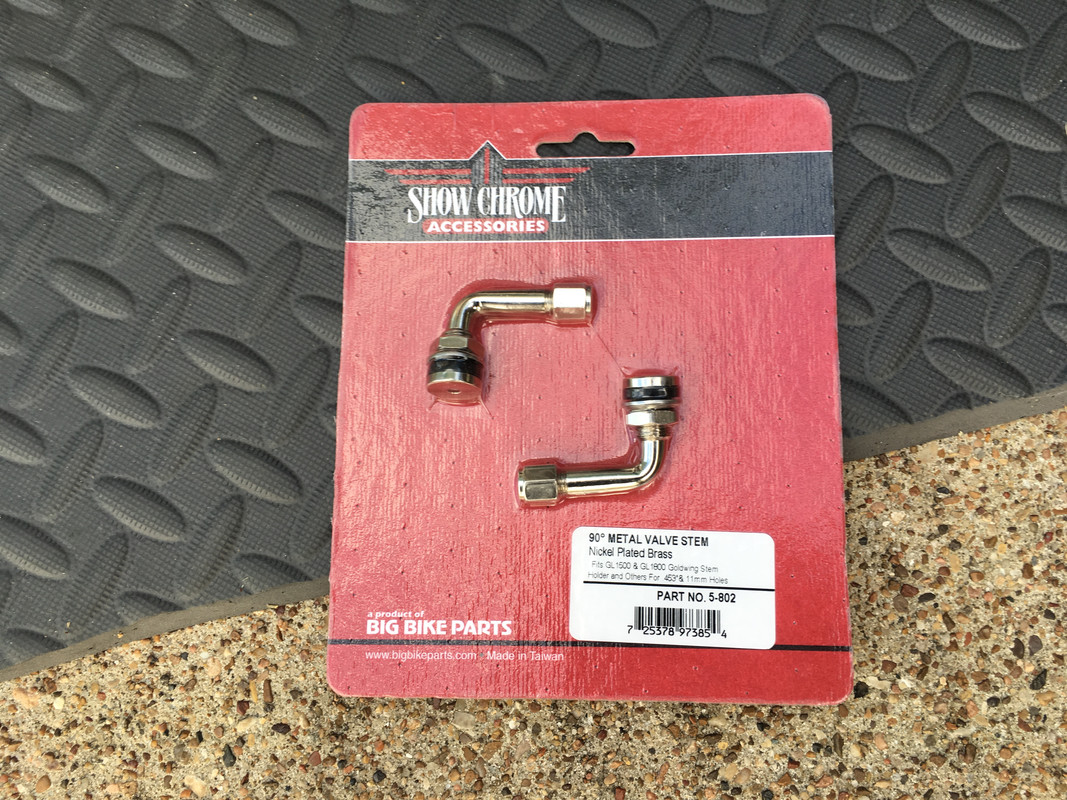

I got some nickle plated 90° valve stems for $10

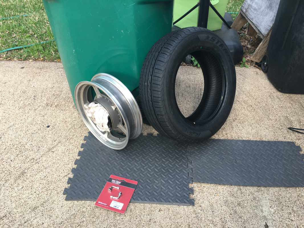

I got a spare rim off e-bay for $55
https://s19.postimg.cc/bk3e9lkf7/2018-03-02_16.26.20.jpg
I want to have a spare rim so if I had problems I could still ride the bike

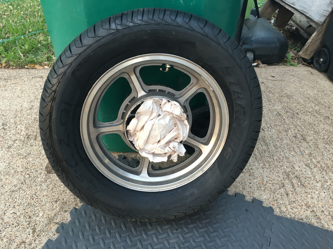

And I still have problems. I can't get the bead to seat.
https://s19.postimg.cc/up6njdeir/2018-03-02_18.08.45.jpg
My compressor will only inflate to ~80 PSI, and apparently it is not enough to get it to pop.
I had cleaned the bead seat (used 320 then 400 grit sand paper) and have tried soapy water and even some Kentucky Jelly. Just not enough pressure I guess (seems 15" motorcycle rims (just over 15") and 15" car tires (just under 15") have a hard time seating, 100 psi is normal from what I can find).
I have also read I may need to reposition the tire (right now part of it is seated, part is not, possibly needs to be all unseated). I will be trying that tomorrow, and if not, Monday have a friend with a compressor that I can do up to 120 psi (don't want to go that high though).
