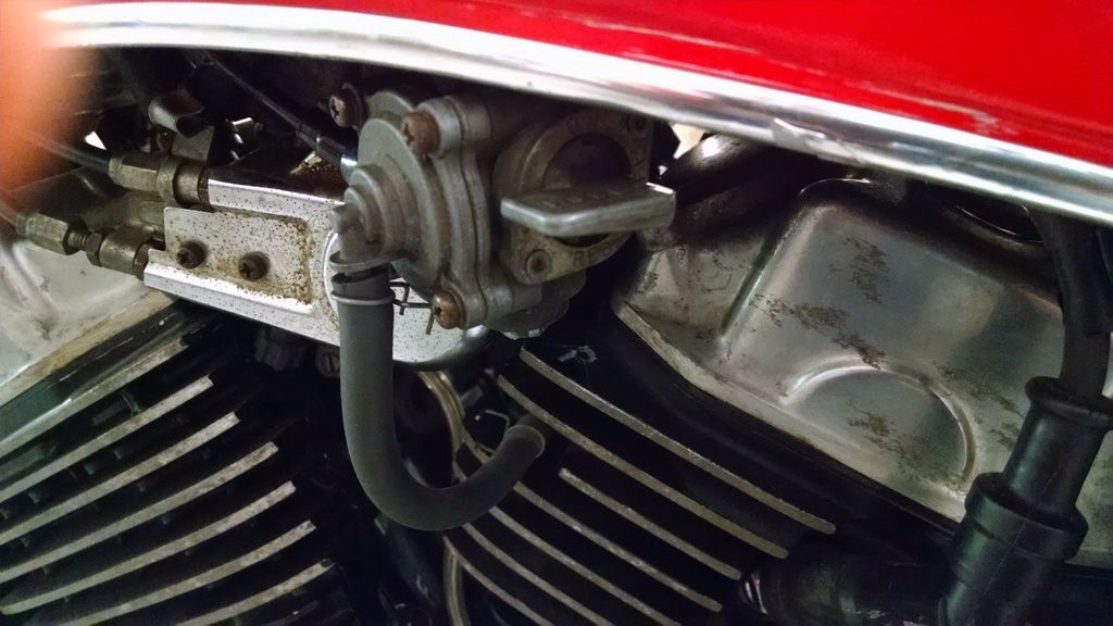

I bought this bike back in Feb. of this year. It had a bad rod knock, so we tore it down and replaced the crankshaft, push rods, and push rod bearings. It is running fine. I can start it, drive it wherever I want to go, but if it's hot, it does not want to re-start. After a bunch of reading here, I decided that the fuel system might be creating a vacuum, so I started poking around. I noticed that the fuel shutoff valve has this vacuum line;
The new fuel shutoff valves do not have the vacuum line;
Honda Shadow Aero Sabre Spirit 1100 Ace Tourer Gas Fuel Tank Petcock Valve | eBay
Does anyone have experience with this problem, or should I be checking another part of the fuel system?

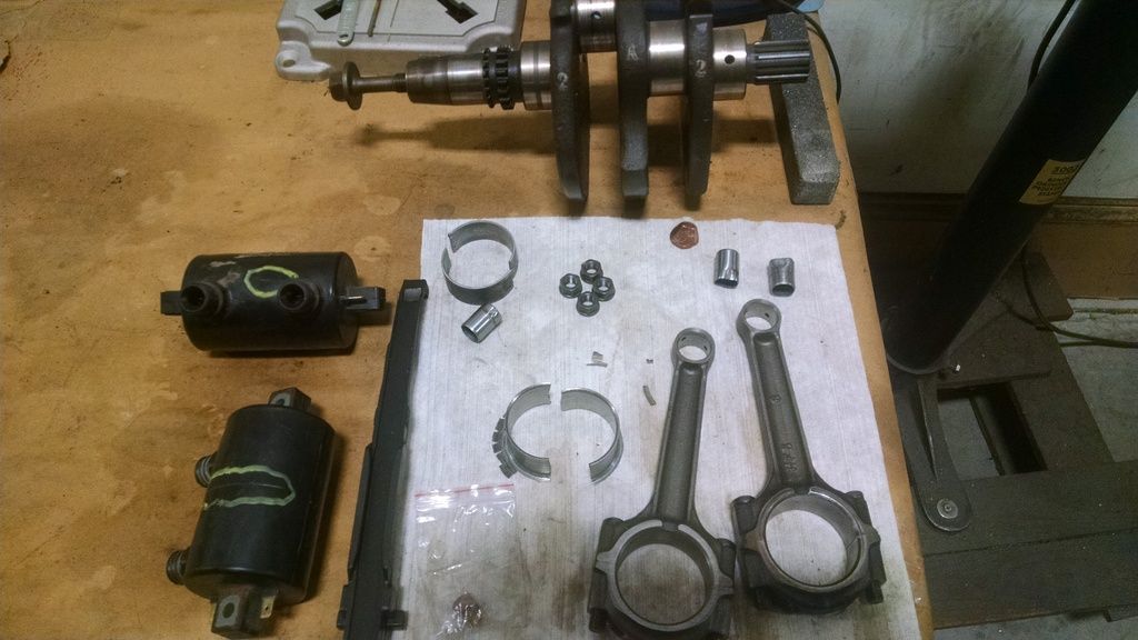

Finally got this issue resolved, it was the coils. Cracks are circled in yellow paint marker.
I just wanted to thank everyone on here for all of the help that I have received. I'm riding this bike every day now and enjoying every minute.

I did get the wires fixed a couple of weeks ago.
I actually started with the cheapest, easiest parts and worked my way up to the coils. I even replaced the voltage regulator, which it probably didn't need.
Yup, them be the culprits and congrats. :D
Sure glad to hear you have it running good!~
Where did you buy the coils since I may need some in the future.
WWW.hondadirectline.com
As recommended by several forum members, pricing was a few dollars less than other places, and I had them within a few days.
