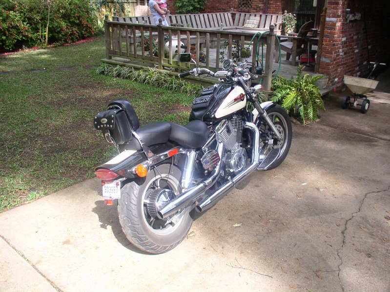

I tried the Spirit 75 drag bars and risers on my 1100 Spirit. Loved the look, but then I turned the bars and the control housings hit the tank. :evil: :evil: :evil: :evil: :evil:
So, off came the drag bars (they're for sale, BTW), and I put on a set of VLX handlebars with the 750 risers. A perfect fit! And my hand, wrist, shoulder, and neck pain is gone, even on extended rides. I think they look much better than the stock buckhorns. The total pullback didn't change much, so all the original cables and wiring is still in place, although I rerouted things a bit.
I can send pics if you like.

Here are the pics. I still have to polish the 750 risers, a rainy day project since there is no winter here in Montgomery!
