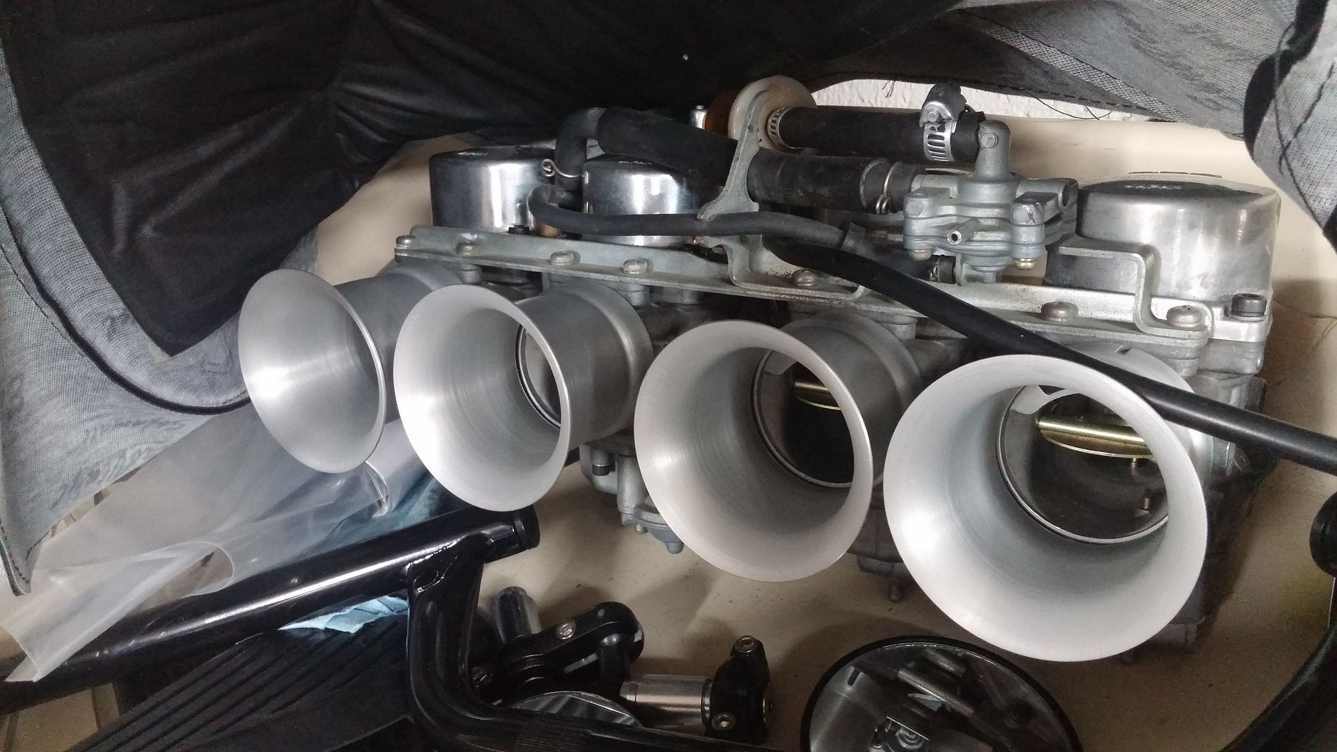

This weekend I tore down the carbs first to see what jets where in it and second to verify the rebuild that the dealer out of Michigan said they did. Well, they did and nice work as the carbs looked pretty fresh inside. Jets however were stock and those will need to be upgraded for the sake of more planned inhalation.
