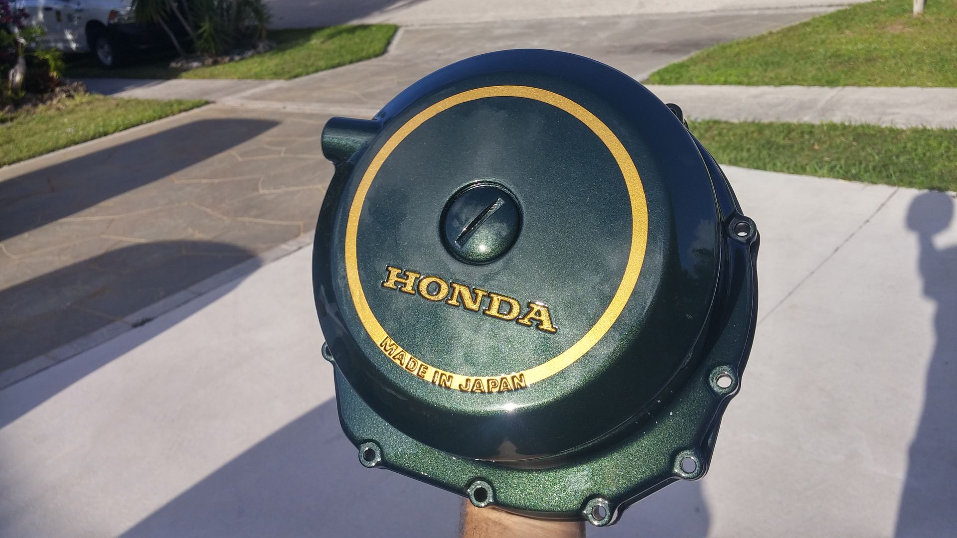

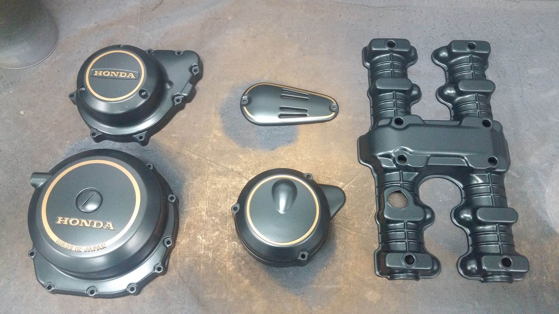

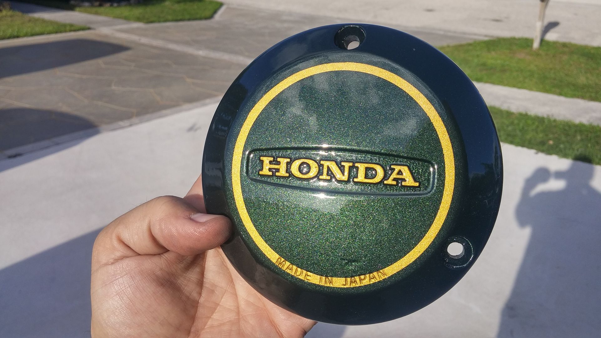

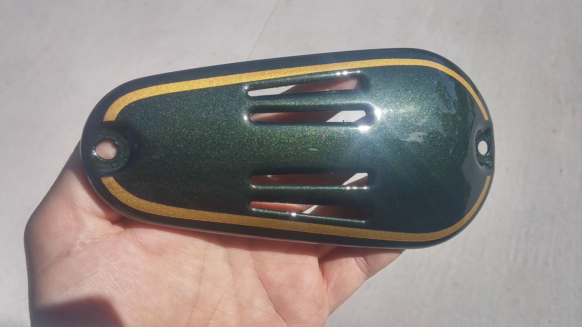

Had a minor creative disaster recently. I chose to paint all the engine covers gray and then matte clear them. In my mind I thought the contrast with the gray frame would look good. ... Nope. So bad, I forgot to take pictures, haha! Anyway, after some thought I decided to bring the body color down into the engine area. Some paint, some masking, some detail brushing and clear. Viola!
