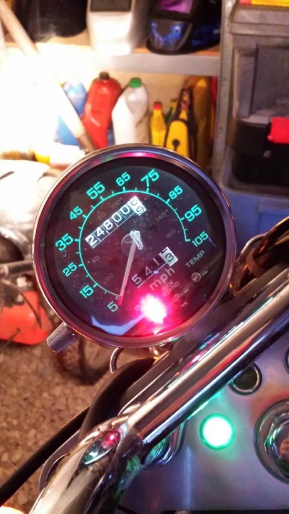

Just wanted to thank you folks for the information. I started last night in search of the Sylvania bulb and could not find one so in a hurry I got a "Pilot" brand from wally world, short story its a POS(I know if I had only waited and bought the correct bulb). So on the way to work this afternoon I went to a different wally world returned the pos and got the Sylvania 168,194,2825 Led Bulb. (Just for grins & giggles the Sylvania bulb is rated at 50 lumens which does not sound like much, but its much brighter than stock.) World of difference, much brighter than the stock bulb, now I'll be able to actually read the speedo at night!

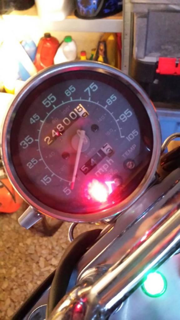

before
after

Whelp i got her in! I'm very happy with the results. Very fast shipping, took me about 6 minutes start to finish to install.
I went with this LED -- https://www.superbrightleds.com/mor...led-bulb-5-smd-led-wide-angle-wedge-base/206/
I did the white color, since the MPH and everything are already green i figured white would probably do the best.
This is how it was, quite dim, especially at night. Couldn't hardly see how fast i was going!

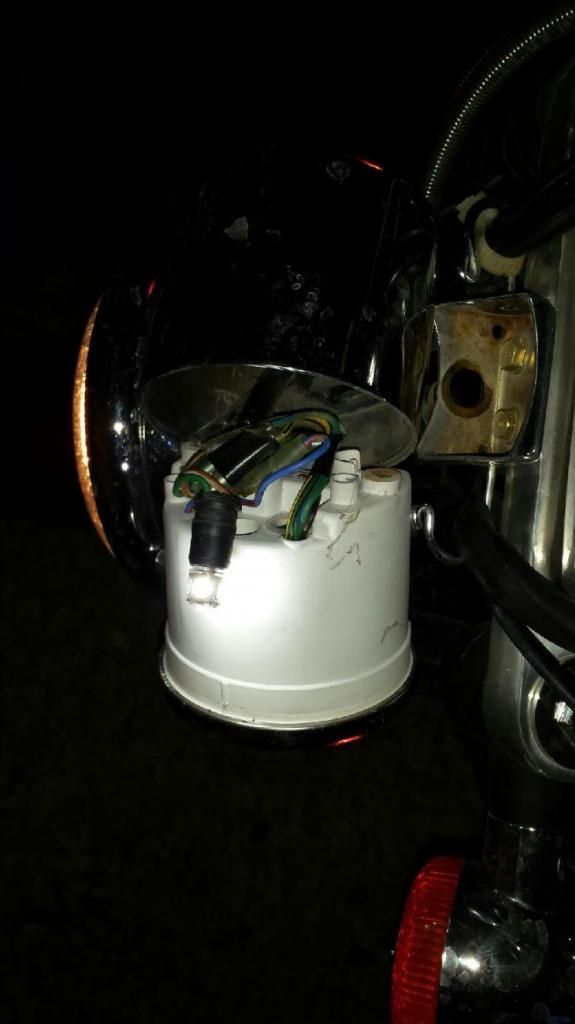

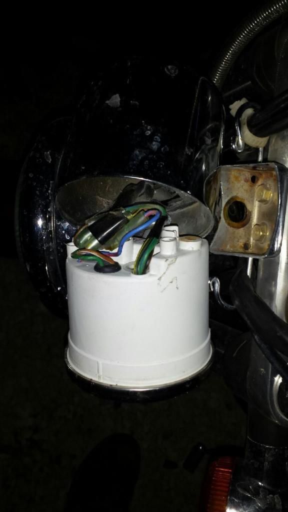

i took off the 2 screws on the back of the speedo, then it slid out. It looked like this. The 2 wires with the rubber casing around them is the light. I just tugged on the wires and it slid out.
It looked like this
Then i poped out the old bulb and slid in the LED and tested it, She lit up like a kid in a candy store.
Then i put it all back together and i could actually see my speedo! Improved alot and it took me 6 minutes and about 8$ to do. This will help me out a lot in my riding.
