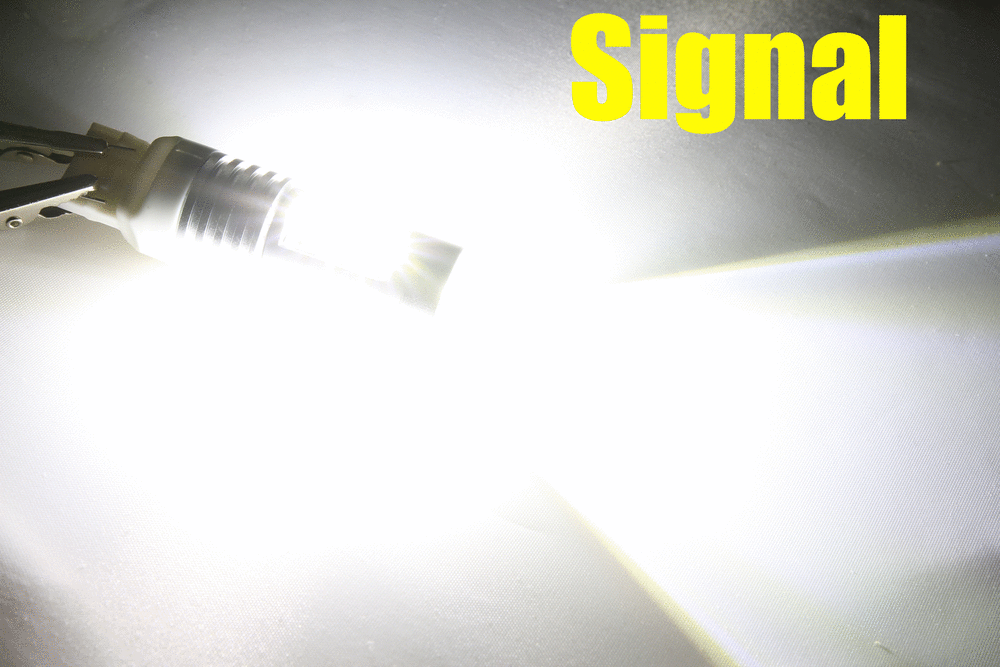

front turn signals LED SWITCHBACK LIGHTS
well I'm sure that you guys saw my review on the switchbacks. but ill add one here. they have 3535 LED chips with a projector lens in the front. when on they are white and when you turn on the turn signal they change to yellow. if you put these in the from you really need to change the front lenses to clear to get the affect. the white light is 650 lumens and the yellow 350 lumens. its a 1157 bulb for the front. its also a cheap way to get a front light bar without spending the cash for a light bar. the amount of light that it produces is amazing. its night and day difference. i could not be more impressed by these.

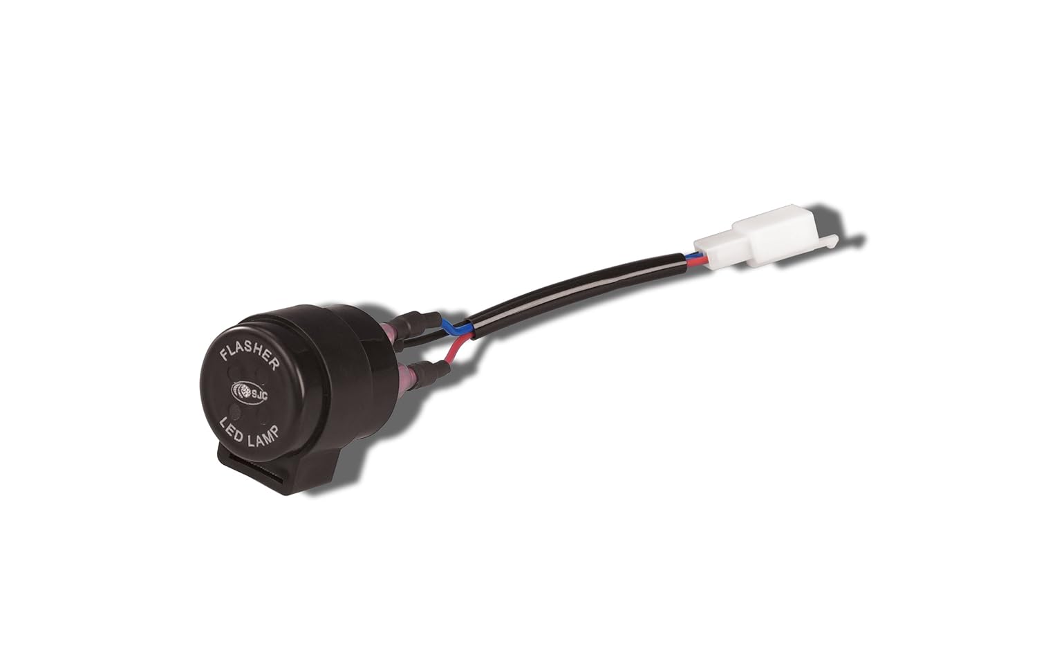

all of these lights are well worth the time and money for them. not only are they brighter by a long shot. they save power on your bike so they don't put a added strain on your battery and charging system. one thing to note is that if you want to use LED lighting for your signals you will need to change the flasher relay show chrome makes a plug and play flasher relay for out hondas. without you may get hyper flash. you could also wire in resistors which at that point will defeat the purpose of saving the electrical energy that the LED bulbs will give you.
show chrome 13-306 LED flasher relay
Amazon.com: Show Chrome Accessories 13-306 LED Digital Flasher Relay: Automotive

I just recieved the front led turn signal lights you tested and reviewed. I put them in, and they are incredibly bright. However, when I turn on the turnsignal switch, all four of my turn signals start flashing, kind of like hazzard lights. I have not installed the plug and play relay, as I am still awaiting its arrival. (I couldn't wait to see how the new lights would look). Will the relay solve this problem? Where does the relay actually PLUG into so I can get out and PLAY?

the relay you are replacing is in the headlight bucket at least thats where mine was. to know for sure turn the key on and a blinker and listen for the clicking and thats the relay to replace. did you do all 4 led or just the front 2?
