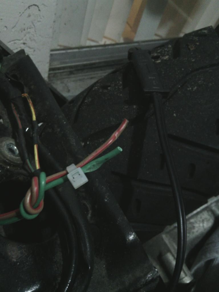

Thanks for the response guys, captain d, the wiring is stock. when I "bobbed" my bike I removed the tail light and license plate light. The license plate light wiring which i wont be using looks like this...
Here's what my tail light looks like....
I'm stumped, I hooked the 3 wires up and it lights up good but just stays on.

How are the wires connected from your brake light assembly (A) (green,brown,green/yellow) to the new license plate (B) (black,red,brown)? Which wire connects to which wire from A to B?

I see two green/one brown...
Did these two green tie together at one time?
Br/r with a green...
Probably need to use br/r for running light???

By your post you should be connected like this:
Factory -----------------------------------------New light
Green (doesn't matter it's ground) ------- Black (ground)
Green/Yellow (stop lamp) ----------------- Red (stop lamp)
Brown (running lamp) --------------------- Brown (running lamp)
Green (2nd ground) ----------------------- Not used
Brown/Red (ignition hot) ------------------ Not used
You do not need the wiring for the license plate light as these usually use the "running light" as the license plate light also. If this is how you have yours hooked up then reverse the stop and running lamp wires as they may be mislabeled.
There is a catch to this however. If your new light also provides the lighting for your license plate you may want that light to come on when you turn the ignition on (personal preference) and in that case you would use the Ignition hot Brown/Red as the "running light" wire instead.

Captain D the new brake light is a dual filament bulb. Wlmmrtn, I had the lights hooked up like you wrote but both elements are lit up so I reversed the red and brown and now it's Dim. So I think the issue is with the brake light switch, what I don't get is it is a new brake light switch, well "in good working order" switch. When I press on the break nothing happens, so tomorrow morning I'm going to ride over to my brothers and get my meter. Thanks guys for your help so far! I love this forum nothing but cool cats!
14 Posts
Discussion Starter · #14 ·
You know what it was guys up by the throttle the previous owner had it jumped that white with green and green with yellow stripe. I unplugged the jumper and what do you know I have working brake lights. However the running lights aren't working but I have no plans of riding it at night.
