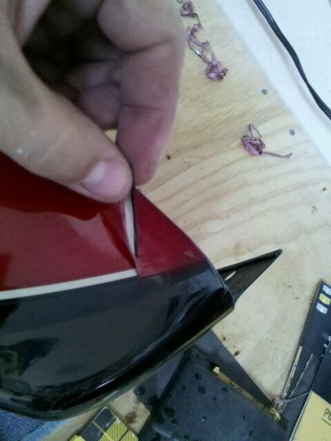

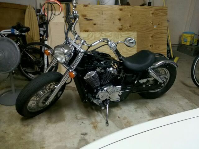

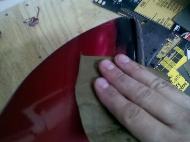

As with anyone, I'm not made of money and this is probably going to be as inexpensive as I can get. However, I've certainly gone and did it now; started sanding down the flawless factory paint on my '03 ACE. Post dis-assembly, I noticed the front and rear dividing stripe was simply a decal which was pretty easy to peel right off. I then went at it with combinations of 400 and 600 grits. I wet-sanded simply to keep the dust down as I'm working next to my other baby in my garage. This also made the process easier to boot. I only got to the rear fender tonight, but I'll be tackling the front tomorrow. The fuel tank clear coat is a bit thick over the striping, so I'll just be sanding that down without peeling first. I bought some semi-flat black Dupli-color paint that I'm going to test. If not, I'll be hitting the professional automotive paint store for some hot-rot black or anything else that strikes my fancy! So far, so good (crosses fingers) ......

More sanding today ... I find it interesting that the fender pinstripes were stickers and the tank seems to be painted. At first I thought it was a decal from the slight bump in the clearcoat, but it sanded completely smooth. I also happened to find a simple air-brush gun that I used many years ago when building scale models ... hmm, I guess we'll see where that goes. So continuing on my quest. Will finalize sanding details tomorrow. More boring pics :mrgreen: ...
