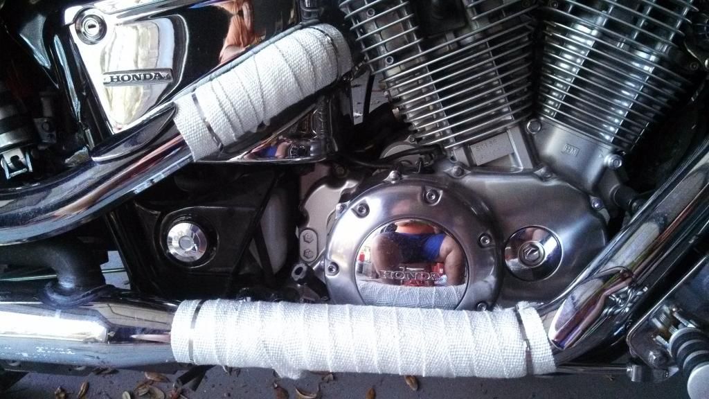

I got three leg burns in a matter of a few days with my new '05 Shadow Spirit 1100. The ONLY other v-twin I've had, was a Vulcan 750, but there was an exhaust pipe on each side of the bike, and pipes were routed more under the bike, rather than on the side.
The Shadow burns happened getting on and off the bike, and at red lights; NEVER while riding down the road.
Here is my fix:

1,439 Posts
Wrapping the raw exhaust pipe with high quality heat wrap then putting the heat shields over them works to a good degree. I think it works better than wrapping over the heat shield or just wrapping and not using the heat shield. This what I did on my 87 vt1100c. But in shorts? Living dangerously. I do it and when I do I'm likely to get a burn. But with the wrap under the shields it far less painful.
