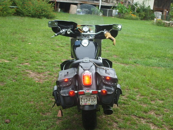

You could add lights like the small chrome LED lights with white (actually clear lens which produce a bright red light) that are mounted above my reflectors.. They are on as running lights and double in brightness when brake light is used and are very bright. Can be picked up cheap on ebay. Have had these on the bike for 3 years without trouble.

I added this to my existing aftermarket red turn signals:
http://pages.ebay.com/link/?nav=item.view&alt=web&id=141293765488
It's nice that when I'm riding my brake light and two turn signals serve as running lights and will flash 3 times when I hit my brakes. One if the better additions I made to my bike. It's kuryakyn so it's extremely easy to install.
