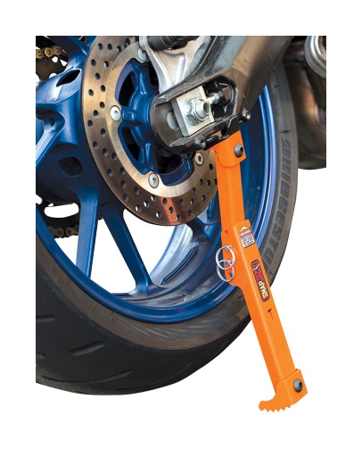

Just ordered a couple CO2 inflators and cartridges, I've had good luck with tire slime in my work truck tires, so for now I'll make a kit out of those, then for long trips I'll make a bigger kit, tubes, patches, tire irons and I have a few ideas for a lightweight folding stand/ jack or a concealed powered or manual centre stand, I've seen Goldwings with electric centre stands.

Pack Jack or Snap Jack is what you want, I’ve seen people make adapters that fit around the swing arm to allow rear wheel removal. Gets the rear tire a few mm off the ground, which works for mostly open rear fenders. Full rear fenders I have no idea what I’d do for a portable, probably bring along the tools to remove the fender as well. I’ve also seen people pull the bike up onto the side stand and wedge a vertical 2x4 under the swing arm to get the rear tire off but that’s a two man job.
