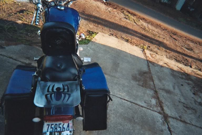

A friend of mine who rides a harley softail has one in. I was behindhim on a group ride, and it almost completely was washed out in daylight. Not bright at all...I had to really watch him to see if he was slowing or not. It has been my experience that most L.E.D. lights end up not as bright as the incondescent ones. That being said, I have tried a few in my '89 shadow, putting an L.E.D. on one side, and incondecent in the other...the L.E.D. is a spot, and the conventional bulb is brighter, lighting the whole side up. I have seen L.E.D.s that have rings of LED lights around the periphery, and they seem like a better choice with all the different angles. Never tried those, and "testing" is prohibitively expensive! I believe the right LED may be a great idea, but I have yet to see one good, consistent brighter unit for general application. I run one behind my sissy bar's metal spiderweb as an extra tail/brake light, though!-----Metalguy :wink:
http://img.photobucket.com/albums/v240/metalguy/019_16A.jpg
