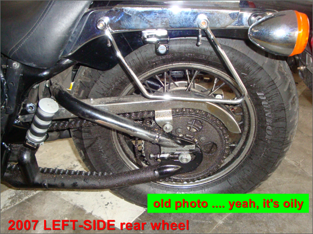

you can clean with kerosene. But unless you're running something like an RK bling chain I don't see the sense of grunge brushing the chain. Cloth or a rag should suffice. You'll liable to get grit pass the o-ring seals between the sideplates compliments of the brush bristles. From there the kerosene, etc. will disolve the lube in the rollers. Nothing's more healthy than a greasy chain, mind you, non-fling stuff. I use DuPout wax spray. Many use BelRay spray, same wax formula. Seems like everybody and their uncle makes no-fling chain spray nowdays. More options for you.
[edit]
just between us, you don't necessarily want this (pic below, 90 wt oil), but even with the non-fling spray stuff, it's advisable every so often to wipe errant spray off the tire so the little there is doesn't migrate down to the tire threads.
